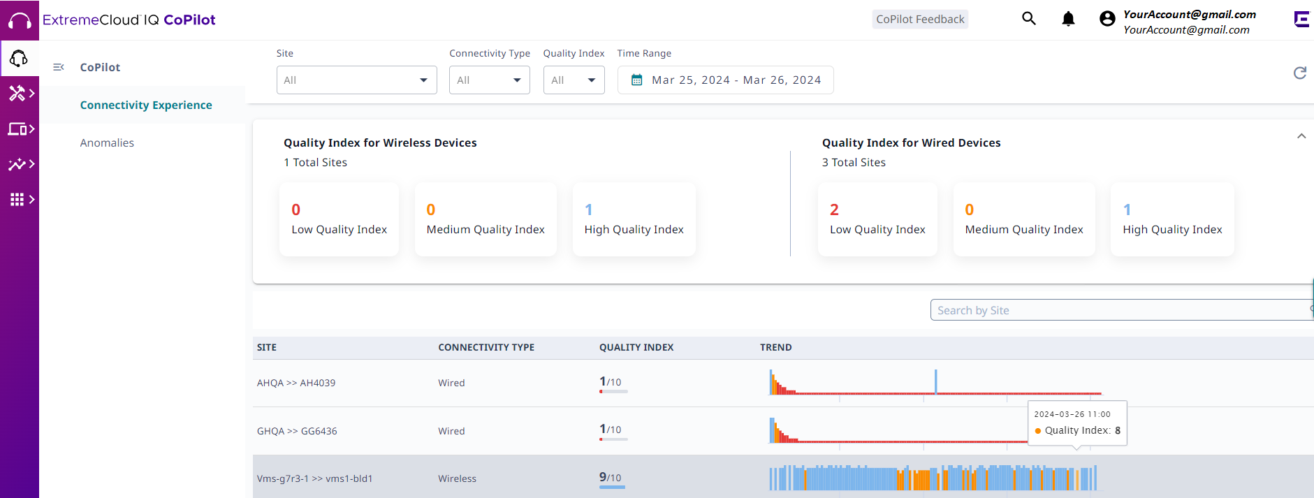

Connectivity Experiences Table
The Connectivity Experiences table displays connection quality information for the previous 24 hours, and includes the following information for each entry:
The table displays connection quality information for the previous 24 hours. Use the controls found at the top of the page to customize your view of the table:
Site
Display all sites (default) or select a specific site from the menu. Start typing a site name to search the menu for a particular site.
To return to the default view, select X.
Connectivity Type
Display all clients (default), or select only wireless, or only wired clients.
Quality Index
Select Low (1–5), Medium (6–8), or High (8–9). The table updates to display the wired and wireless sites that match your selection.
Time Range
Use the calendar control to select the time period for which you want to display connection quality trends information. Select the calendar control to open it and then select one of the options:
  • Last 24 Hours
  • 7 Days
  • Custom
    Select the start date and time, and then select the end date and time for the period. Select up to 7 days, from 90 days of historical data.
Search by Location
Start typing a site name to search the table for a site. Select X to clear the search string and return to the previous table view.
To sort the table results in ascending or descending order according to Site. Hover the mouse to the right of the corresponding column label, and select the Dimmed arrow icon. To change the sort order again, select the Arrow icon,. You can also search for connection quality information by site. Use the Items per page menu to specify the maximum number of results to show, per page.
